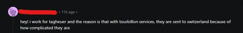

It's been more than a week and they haven't even received it yet. The attached photo probably explains why..
